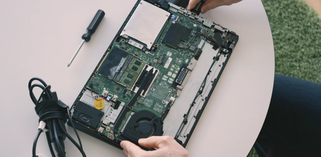

Basically, Olle and Pasi discovered a weakness in how computers protect firmware. The researchers say that attackers able to gain physical access to a targeted computer can exploit this weakness to perform a successful cold boot attack, allowing them to steal encryption keys and other sensitive information.
Cold boot attacks aren’t new. They were developed by a research group back in 2008. Those researchers found that when a computer is reset without following proper procedures (what’s known as a cold/hard reboot), they could steal information that briefly remains in the memory (RAM) after the device loses power.
Because cold boot attacks are nothing new, there have been developments to make them less effective. One safeguard created by the Trusted Computing Group (TCG) was to overwrite the contents of the RAM when the power was restored.
And that’s where Olle and Pasi’s research comes in. The two experts figured out a way to disable this overwrite feature by physically manipulating the computer’s hardware. Using a simple tool, Olle and Pasi learned how to rewrite the non-volatile memory chip that contains these settings, disable memory overwriting, and enable booting from external devices. Cold boot attacks can then be carried out by booting a special program off a USB stick.
